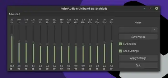

I saw that on Windows machine you can increase the bass level of the sound that is outputted on headphones. How can achieve this on Ubuntu or Linux Mint using PulseAudio Equalizer?

In order to get the nice bass sound on your headphones on Ubuntu 16.04+ and Mint 18+, you first need to have good headphones. I'm using Apple's headphones. The next thing you need to do is to put the preset on Party and slide the first column just little up, around ~15.4db and you will get that nice bass output just like on Windows machine.
