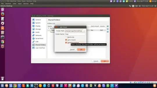

[edit] Screen [2] asked in comment:

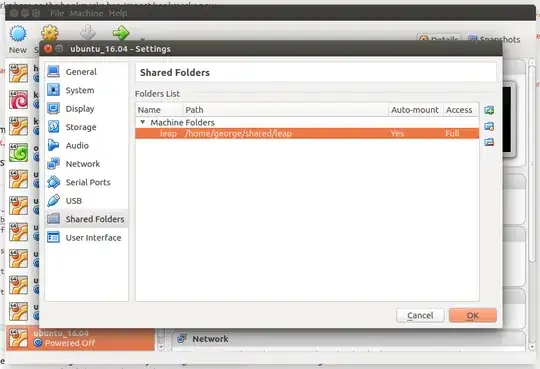

One of the benefits of using Virtualbox is ability to add guest-additions to the host making it possible to interact seamlessly between host and guest OSes.
To set this up add the guest additions via either the command line for Virtualbox installs using the official repo, or from the oracle site if using .deb files to install.
Now to setup folder sharing we need to:
  1. Add the guest additions as mentioned earlier
  2. Add the desired folder from:
    • virtualbox settings menu for the guest OS in question, or
    • from the the devices menu from the launched VM
  3. Select the options:
    • Auto-Mount and Make -Permanent
  4. In the guest Ubuntu OS add your user to the group vboxsf:
    sudo usermod -aG vboxsf $USER
  5. Restart Ubuntu so the new group addition gets picked up
  6. And note the convention is to name the folder with a "sf_" so look for a file named like so sf_******** in the /media folder. Example: /media/sf_vbox_share
You don't need to manually mount that shared folder, that's what Virtualbox Guest Additions are for.
