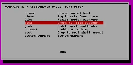

Just some comments:
  1. To enter the GRUB menu press and hold SHIFT while booting
  2. In Recovery Mode better to choose "fsck - Check all file systems", see picture.
Great description here: How to Use ‘fsck’ to Repair File System Errors in Linux
