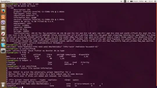

I have an Ubuntu 17.04 instance that randomly locks up. Nothing responds so I have to turn off the PC using the power button.
I've realised that the issue starts when I try to reboot my computer... Sometimes the wifi stops working for like 15 seconds and then asks me for the wifi password.

Do you have an encrypted swap?
