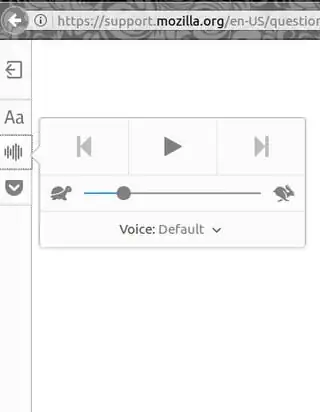

The default voice as well as all alternative voices are very difficult to understand.
I cannot find any documentation about how this feature is wired up.

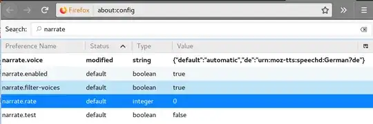

Some settings are available via the about:config dialog if you search for "narrate":
I experimented quite a bit with different settings in both, about:config and speechd.conf, but could not get anything to work but the default that comes with Ubuntu. The feeling I get is that the interface between firefox and speech-dispatcher is not very stable, but maybe you are more lucky experimenting.
