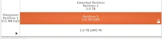

I open Disks and I see the 2TB drive and the graphic shows the following:
2TB drive cofiguration
The problem is that I do not seem to have access to the large 2TB partition, just to the little pre-boot area.
From the image, you can see the lock is unlocked. It says it is unlocked. It says the device is /dev/sdb5.

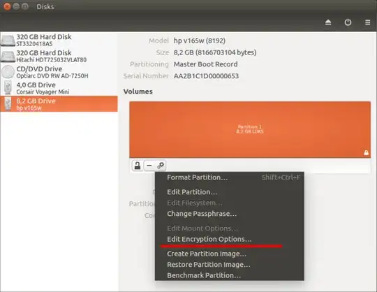

2. Select the device, select the encrypted partition. Don't unlock it yet. From the 'Gears' menu select Edit Encryption Options:
3. Into the dialogue box Encryption Options:
  • Set Automatic Encryption Options to OFF
  • Tick the option Unlock at startup.
  • Enter your Passphrase.
  • Then press OK (and authenticate yourself into the next dialogue).

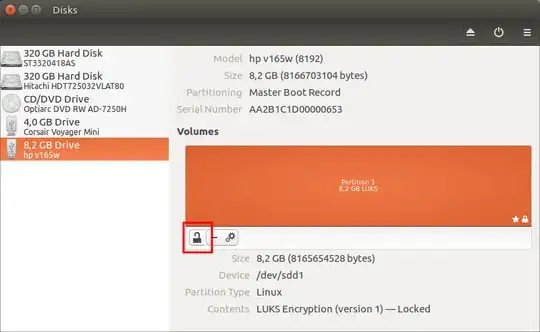

4. Click on the 'Padlock' icon to unlock your encrypted device:

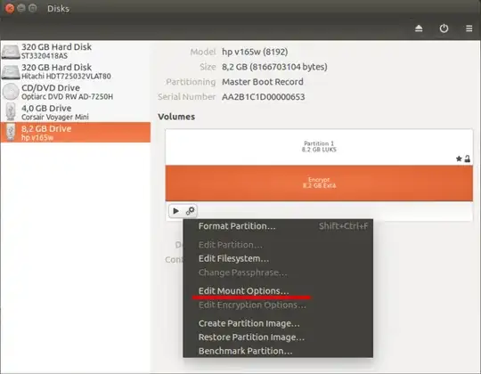

5. Now select the partition (the inner part) and from the 'Gears' menu select Edit Mount Options:

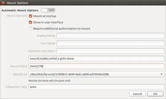

6. Into the dialogue box Mount Options:
  • Set Automatic Mount Options to OFF
  • Tick the option Mount at startup.
  • Tick the option Show in user interface, if you want.
  • Change the Mount Point.

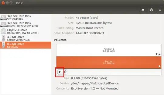

7. Now press the 'Play' button to mount your device:
