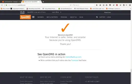

You can test that this is working as advertised by visiting https://welcome.opendns.com/ in your browser which should provide the following feedback: For listing the currently used DNS servers see: Command-line to list DNS servers used by my system
