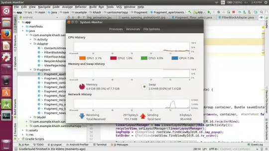

From the System Monitor image you attached, the RAM usage is 89%.
You aren't using the entire RAM of your machine - hence there is no need to use swap file on disk.
Also, it is clear that you have 7.6GB of swap file, 2MB of the file is in use (which is about 0.0001% of total swap file)
