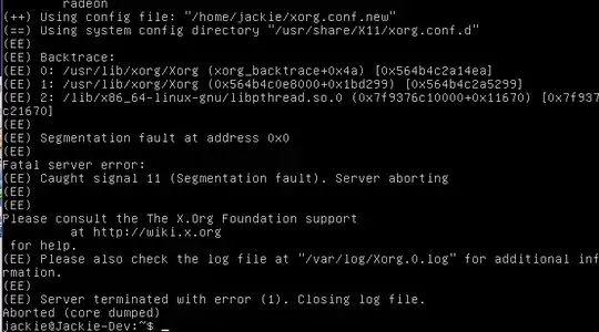

When I run sudo X -configure

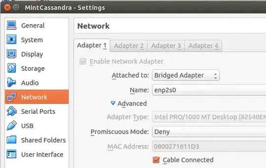

I don't exactly know what you mean by 'new drive' but creating a new OS from a VirtualBox 'VDI' image of file should be done like this:
  1. Have the 'VDI' file ready in any folder
  2. Create a new OS on Virtualbox device using the usual steps, but when at the 'HARD DISK' step choose the option 'Use an existing virtual disk file':
  3. Select the 'VDI' from step 2.
  4. Set up the Network and choose the 'Bridged Adapter' option:
  5. Now start the Virtual VM.
Image(s) courtesy of linuxbsdos
