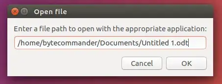

You can get a simple dialogue window that prompts you for a path to enter and then opens it with the appropriate application using xdg-open when you click "Ok".
This command uses zenity (normally preinstalled) for the dialogue window and xsel (you might have to install it using sudo apt install xsel first) to already insert your current clipboard content into the entry field as default value - that means you can even save the keystrokes to paste!
openpath="$(zenity --entry --title "Open file" --text "Enter a file path to open with the appropriate application:" --entry-text "$(xsel -b)")" && xdg-open "$openpath"
zenity dialogue
This command can be run from a terminal, but it is even more useful as a keyboard shortcut. You can go to System Settings > Keyboard > Shortcuts > Custom Shortcuts and assign it to a custom shortcut, like e.g. Super+R. Note however that it must run in a Bash-compatible shell, sou you have to wrap it in bash -c '...' to use it as shortcut:
bash -c 'openpath="$(zenity --entry --title "Open file" --text "Enter a file path to open with the appropriate application:" --entry-text "$(xsel -b)")" && xdg-open "$openpath"'

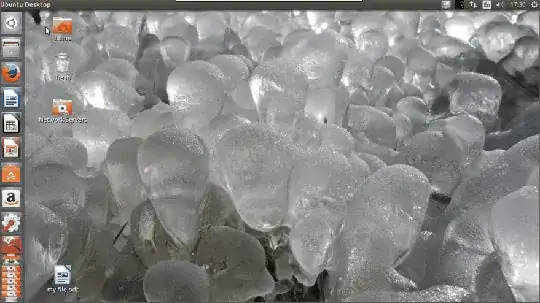

While the other answers provide different ways how to simulate »Windows Run« behaviour, I accidentally found a way how to simulate »Windows Explorer« behaviour.
Within Nautilus
  • Open Nautilus and press Ctrl+L. This shortcut will switch Nautilus to show the Location bar instead of Breadcrumbs.
  • Paste your path in the Location bar and press Enter two times. The first Enter will open the location directory and will highlight (select) the target file. The second one will open the file.
  • If you want to set the Location Bar in Nautilus as default check this answer: Switch from path bar to location bar permanently in Nautilus.
Within Nemo
  • The approach and the shortcut (Ctrl+L) are exactly the same as above.
  • Nemo will remember your choice and you don't need to switch its default behaviour.
Demo
