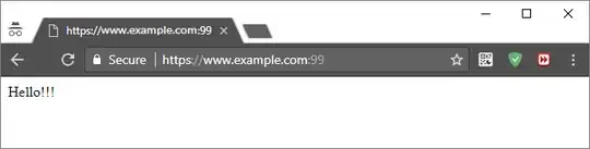

  • Try to open https://www.example.com:99 via the browser. The result should be:
