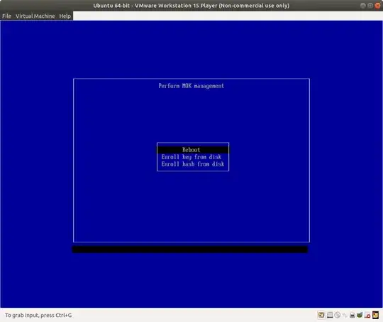

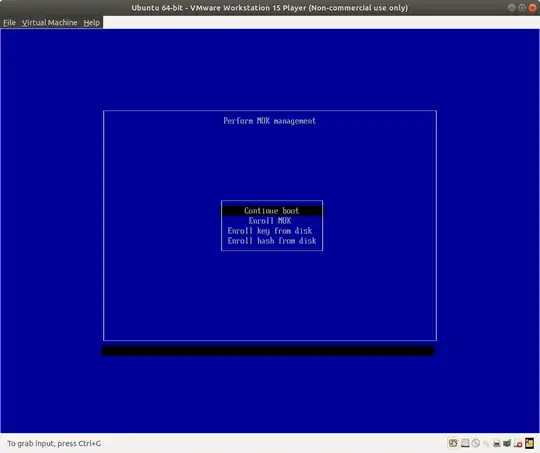

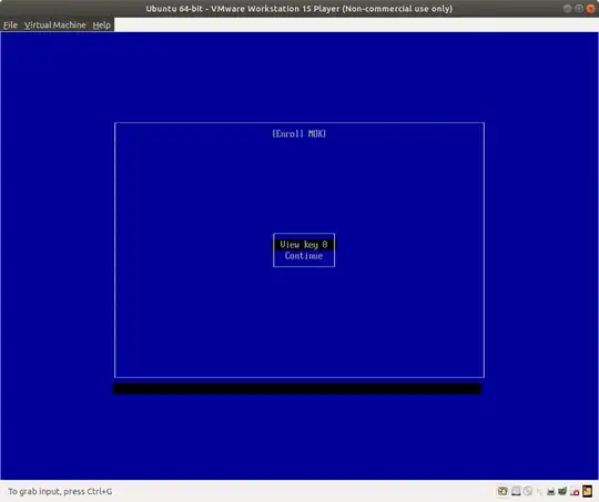

I have the same issue on a Taichi X370 motherboard and 1050Ti GPU with the MOK management menus not being visible. I tried enrolling a key in a vm just to see how the menu layout looked.
Press down once and Enter for Enroll
Press down once and Enter for Continue
Press down once and Enter for Yes
Type in password and Enter to accept
Press Enter to Reboot
With the above I could blindly enroll a new key in MOK management.
