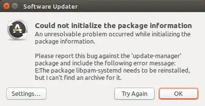

Here is the error:
E: The package libpam-systemd needs to be reinstalled, but I can't find an archive for it.
When I try to update Ubuntu 14.04, I receive the following pop-up windows:
Could not initialize the package information An unresolvable problem occurred while initializing the package information.
Please report this bug against the 'update-manager' package and include the following error message: E:The package libpam-systemd needs to be reinstalled, but I can't find an archive for it."
I reviewed the following post: The package libpam-systemd needs to be reinstalled
When I attempted to input sudo apt-get install aptitude into Terminal, I received the exact same error message.
Per request, full verbatim results from Terminal: https://paste.ubuntu.com/25399467/

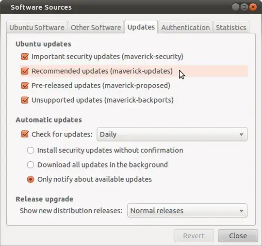

It looks like you had the trusty-updates repository enabled at some point, which pulled in libpam-systemd in version 204-5ubuntu20.14. At a later point that repository was disabled and something damaged the package installation. Now Apt can't find a suitable package archive to reinstall and restore the package.
For a solution I recommend that you
  1. re-enable the trusty-updates repository in Software & Updates (software-properties-gtk),
    Software updates settings
  2. update the list of available packages,
    sudo apt-get update
  3. perform a package upgrade with the -f/--fix-missing option:
    sudo apt-get dist-upgrade -f libpam-systemd
