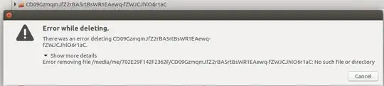

When I try moving it to trash or deleting using Nautilus, it looks like this:
Nautilus showing a similar "No such file or directory" error

If that doesn't help and you continue getting the same No such file or directory message, then the problem is that you aren't successfully naming the directories. Presumably their names contain unusual characters.
It's not obvious that this is the case based on what you have shown but it is a common problem so I'm including it just in case. If your directory names contain spaces or other characters treated specially by the shell like line breaks, *, or $, then you should enclose the names in single quotes. This will be sufficient so long as the names themselves do not contain any single quotes.
More generally, if you've used cd to get to the directory that contains these directories, you should be able to get a list of entries in that directory (including the subdirectories you're interesting in removing) by running:
ls -1b
This differs from an ordinary ls command in two useful ways:
  • The -b flag causes the paths to be printed with escape sequences which can be pasted between $' '. No space should appear between the initial $ and the opening ' character.
  • The -1 flag makes ls list one entry per line. That can help decrease confusion about where one filename ends and the next begins.
This should enable you to write commands that remove, rename, etc. these directories. If they are truly empty, you can then use the rmdir command to remove them. You may need to run this command as root, which you can do with sudo.
