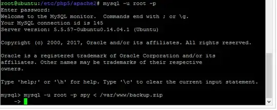

I am using Ubuntu 14.04. I want to import my database which is located on the server /var/www/backup.zip. Also I've SSH access using Putty. Noted that MySQL and phpMyadmin are installed on the server.
When I run this command
mysql -u root -p spy < /var/www/backup.zip
nothing happens. A newline shows which starts with ->.
What should I do now?

I believe the format is:
mysql -u username -p database_name < /path/to/file.sql
From within mysql:
mysql> use db_name;
mysql> source backup-file.sql;
George Udosen
  • 37,534
The main problem is that you're trying to run a bash command from within mysql. If you run that command at the regular terminal prompt the format of the command is correct.
The second issue is that you have a zip file and not a SQL file so you need to unzip it first.
How do I load a sql.gz file to my database? (on Server Fault) explains most of what you need. My answer there should work here too with a slight modification:
unzip -p /var/www/backup.zip | mysql -u root -p mydb
unzip -p unzips to a pipe, so that you can pipe that into your database command. Make sure the zip file only contains one sql file.
mysql -u root -p mydb is going to prompt you for a password (the -p without a value) and then attempt to pipe in the file data to mydb - change the mydb to your own database. You shouldn't specify the password in the command line as it then remains in your command history.
