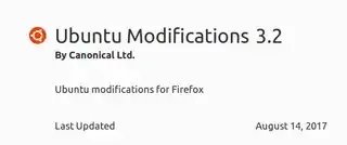

When I opened Firefox 54 (I have not upgraded to 55 yet), I saw that the Ubuntu Modifications are still at 3.2 rather than 3.4:
Fx 54, Add-ons Manager, Ubuntu Mods

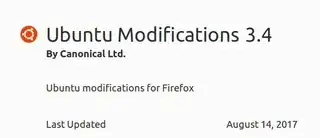

It gets weirder because I also have Firefox 52 ESR installed, and the Ubuntu Modifications in that one did update correctly:
Fx 52 ESR, Add-ons Manager, Ubuntu Mods
