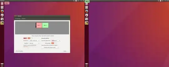

I have installed Ubuntu 16.04.02 on VirtualBox 5.1.26 and have configured the VM to have a second monitor using the Guest Additions.
I want to disable the Launcher on the right-hand monitor, but disabling the launcher only disables it in the mini preview while it persists on the actual desktop. How do I fix this and is this a problem with Ubuntu or VB?
screenshot

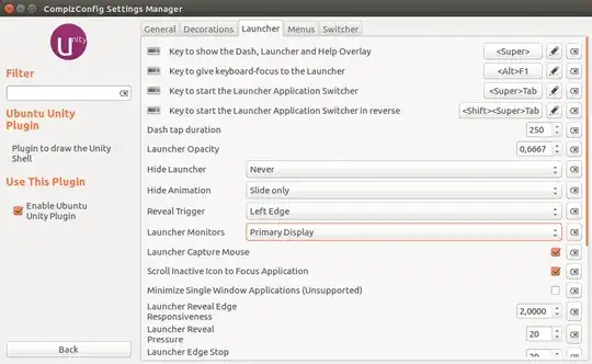

I fixed the issue using the Ubuntu Unity Plugin of CompizConfig Settings Manager. On the Launcher tab there is a a Launcher Monitors setting with an option to set launcher placement to "Primary Monitor", and while Ubuntu system settings did nothing, this was effective.
CCSM Screenshot
