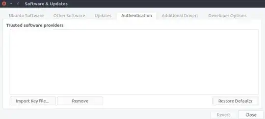

I am also wondering if this has to do with the Trust software providers section of the software updated being empty. Here is a screenshot:
Software Updater gives me the following:
