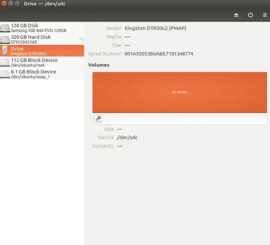

My USB stick got corrupted. I am not even able to format it as it is not found properly by my OS (Ubuntu 16.04).
What I tried:
It is found by neither fdisk -l, lsblk nor gparted.
It is shown by lsusb:
> lsusb | grep Kingston
Bus 004 Device 016: ID 0951:16a2 Kingston Technology
Logs from dmesg after plugging the stick in:
>dmesg | tail -n 11
[55597.440104] usb 4-2: new SuperSpeed USB device number 16 using xhci_hcd
[55597.466711] usb 4-2: New USB device found, idVendor=0951, idProduct=16a2
[55597.466718] usb 4-2: New USB device strings: Mfr=1, Product=2, SerialNumber=3
[55597.466722] usb 4-2: Product: DTR30G2
[55597.466726] usb 4-2: Manufacturer: Kingston
[55597.466729] usb 4-2: SerialNumber: 001A92053B6ABE7181348774
[55597.467697] usb-storage 4-2:1.0: USB Mass Storage device detected
[55597.469243] scsi host32: usb-storage 4-2:1.0
[55598.512257] scsi 32:0:0:0: Direct-Access     Kingston DTR30G2          PMAP PQ: 0 ANSI: 6
[55598.513179] sd 32:0:0:0: Attached scsi generic sg2 type 0
[55598.539725] sd 32:0:0:0: [sdc] Attached SCSI removable disk
usb_storage module seems to be loaded properly:
>lsmod | grep usb_storage
usb_storage            69632  1 uas
gnome-disk-utility finds the USB stick but provides only few information and does not enable formatting it :
Any help appreciated, thanks!

hobil
  • 71
You can try according to this link: Can't format my usb drive ... Analysis of the problem
Particularly you can try the tips in the list
  • On some pendrives and on many memory cards there is a small mechanical switch for write protection, that can toggle between read/write and read-only. You might have set it read-only without intention.
  • Reboot the computer and try again to restore or wipe the first megabyte with mkusb.
  • Disconnect other USB devices. Sometimes USB devices can disturb the function for each other.
  • Try other USB ports and another computer.
  • Try another operating system (Windows, MacOS) in another computer.
  • If you still cannot wipe the first megabyte of the drive, and the drive is read-only, it is probably 'gridlocked', and the next stage is that it will be completely 'bricked'. There is a limit, when you have to accept that the pendrive is damaged beyond repair, at least with tools available to normal users like you and me. See this link: Pendrive lifetime
In your case, if you still cannot see, write to, or format/restore the USB stick as a mass storage device, as a drive, it might be damaged beyond repair.
