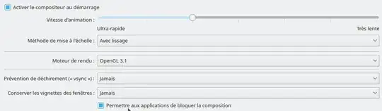

ON KUBUNTU (KDE) :
  • use XRender instead of OpenGL
  • or with OpenGL, disable "vsync"
display properties window

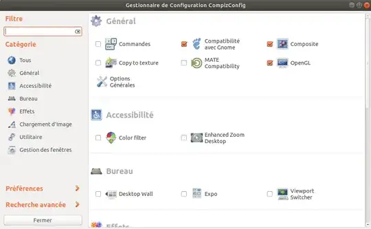

ON UBUNTU (GNOME) :
  1. Install CompizConfiguration Settings Manager (CCSM) with Aplication Center
  2. Run CompizConfig
  3. Check both "Composite" and "OpenGL" !

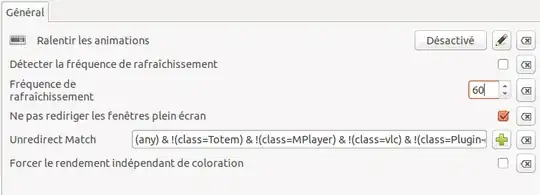

Compiz Config Manager
  1. Let's go in "Composite" tab, uncheck the "automatic refresh detection" and fix your refresh rate to 60.
composite config
Hope it help someone.
