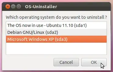

Use os-uninstaller, a graphical tool
https://help.ubuntu.com/community/OS-Uninstaller
You should do this from a live USB rather booting from the hard drive
Install:
sudo add-apt-repository ppa:yannubuntu/boot-repair
sudo apt-get update; sudo apt-get install -y os-uninstaller && os-uninstaller
Launch uninstaller from dash
