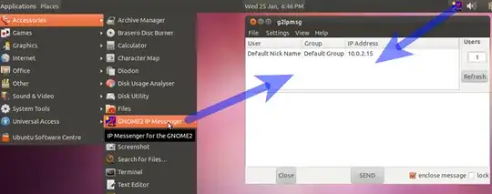

The package g2ipmsg is available in the repositories - v0.9.6 for all versions of ubuntu except for oneiric. Thus to install in versions prior to oneiric or for 12.04 and above:
g2ipmsg Install g2ipmsg
However its not available in Oneiric (11.10) because it doesnt compile under oneiric due to the changes to Gnome-Panel and the dependency on the gnome-2 applet libraries.
You could compile and install to produce this result in gnome-classic (no-effects)
Note - when the application starts - it starts minimised to the gnome-panel. For some reason, in Unity, this application does not appear - probably the minimised application is not directly visible in the Unity panel.
To get the application to work under Unity you need to enable the old sys-tray:
gsettings set com.canonical.Unity.Panel systray-whitelist "['all']"
Then logout and login before searching for g2ipmsg in Dash
I've compiled and added this to my PPA. If you wish to compile this yourself, then instructions are below.
Install from PPA
sudo add-apt-repository ppa:fossfreedom/g2ipmsg
sudo apt-get update
sudo apt-get install g2ipmsg
to run g2ipmsg
  1. If you are using the Gnome-Classic interface, then G2ipmsg will be found in the Accessories menu option
  2. If you are using Gnome-Shell then search in Activities for g2ipmsg and the application will start minimized in the system-tray notification area (bottom right) of the screen. You will need to move you mouse to that area to make the application icon visible. My recommendation would be to use the system-tray extension to make the application icon visible at all times in the top-right of the screen. See my link answer below for more information about these areas and how to install the extension
  3. If you are using Unity/Unity 2D you will need to manually enable the system-tray area for the application to start in the top-right area of the screen next to the indicator area.
