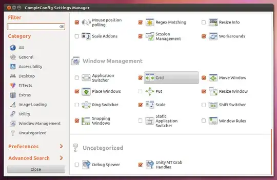

Window snapping is enabled by a Compiz extension: the Grid Plugin. You cannot use window snapping without the Grid Plugin, and you cannot use the Grid Plugin without Compiz.
This answer on a related question seems to indicate that Compiz is required in order to use window snapping in Unity.
