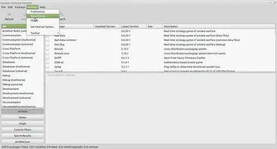

if you have synaptic package manager it will open software sources
here you can disable/enable repositories enter image description here
