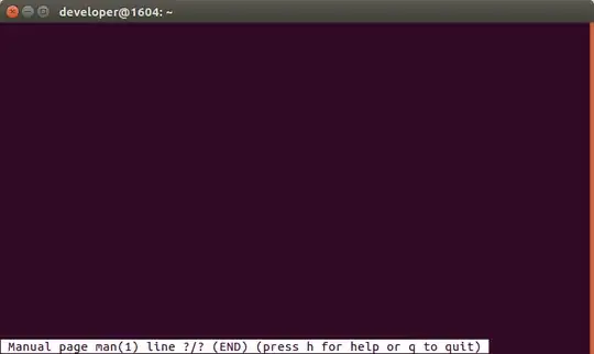

I can't use manpages. The manpages don't display anything. Looks like an empty vi file every time.
I tried reinstalling man-db and reinstalling perl. It didn't work. It seems that my man database is broken.
I even can't try and open a manpage directly, it also becomes the blank screen:
$ man -l man/hello.1
man: command exited with status 3: /usr/lib/man-db/zsoelim | preconv -e UTF-8 | tbl | nroff -mandoc -Tutf8
On OpenBSD it works.

Run:
sudo mandb -c; echo $?
To force mandb to delete previous databases and re-create them from scratch.
At the end you should get "0", if not check for:
1      Usage, syntax, or configuration file error.
2      Operational error.
3      A child process failed.
You can also run: sudo mandb -t to perform:
correctness checks on manual pages in the hierarchy search path.
It helps you to find out what is wrong.
