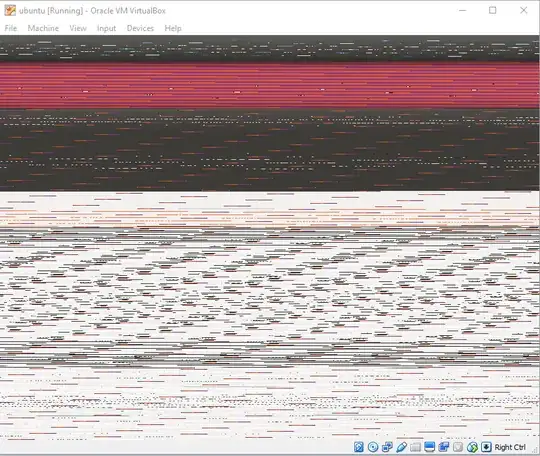

I have seemingly successfully installed Ubuntu correctly, however Ubuntu runs, I see the operating system load normally up until Ubuntu is supposedly fully loaded and what is displayed is a screen of graphics that is terribly distorted.
Here's a screenshot of what is displayed inside the operating system:
Within this screen, I can see the screen respond to my mouse movements, as if it does accept the input, but it's nothing that I can actually use.

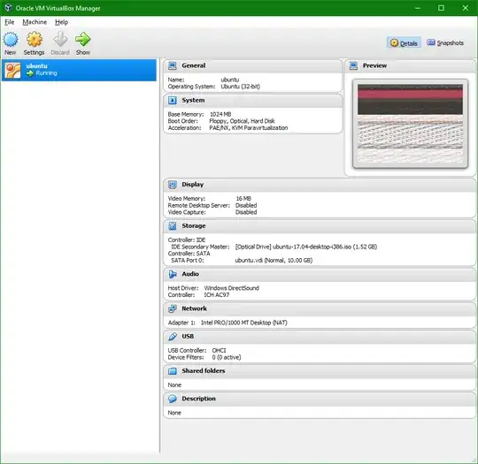

Here is a screenshot of some of the settings I used for the Virtual Machine:
I'm wondering if anybody has had this problem before and knows how to fix this issue.

As memory serves me, switching TTY's should fix the problem.
To fix your video problem, hit the host_key + F1, followed by host_key + F7. It's a bug.
On some keyboards, you may have to host_key + fn + F1 and then host_key + fn + F7
