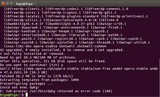

I have an error on Ubuntu 16.04 when I use
 sudo apt-get upgrade

Go to this url http://security.ubuntu.com/ubuntu/pool/main/d/dpkg/ and you will see a list of dpkg packages. You need to find the dpkg version you need than open new terminal. Anywhere your machine I select Desktop.
mkdir dpkg
cd dpkg
Run:
wget http://security.ubuntu.com/ubuntu/pool/main/d/dpkg/
(Add the version of dpkg you need after the last /)
For example I needed dpkg_1.17.5ubuntu5.2_amd64.deb but this does not exist any more so I chose the closest one which is
dpkg_1.17.5ubuntu5.8_amd64.deb
So:
wget http://security.ubuntu.com/ubuntu/pool/main/d/dpkg/dpkg_1.17.5ubuntu5.8_amd64.deb
Run
ar x dpkg_1.17.5ubuntu5.8_amd64.deb
Now you can see the contents:
~/dpkg $ ls
control.tar.gz  data.tar.gz  debian-binary  dpkg_1.17.5ubuntu5.8_amd64.deb
Run
~/dpkg $ tar xfvz data.tar.gz ./usr/bin/dpkg
./usr/bin/dpkg
~/dpkg $ ls
control.tar.gz  data.tar.gz  debian-binary  dpkg_1.17.5ubuntu5.8_amd64.deb  usr
~/dpkg $ cd usr/bin/
~/dpkg/usr/bin $ ls
dpkg
~/dpkg/usr/bin $ sudo cp dpkg /usr/bin/
Then you can run:
sudo apt-get update
I hope that helps.
