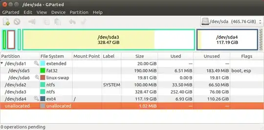

Long story short: I made a dual boot of WINDOWS10 and UBUNTU16, all worked fine until I tried to reinstall the UBUNTU part.. I somehow ruined the boot loading, I finally made it to reinstall UBUNTU but no sign for the windows10 side(grub menu at boot got only ubuntu)

Along the reinstall I tried to be as careful as possible not to touch the windows partitions at all (sda2 and sda3 in picture below)

I can't be 100% positive, but it looks like you have a BIOS/CSM/legacy-mode install of Windows on an MBR disk, then installed Ubuntu in BIOS/CSM/legacy mode, and this worked fine. When you re-installed Ubuntu, though, it appears that you booted the installer in EFI/UEFI mode, which caused it to create, or prompted you to create, an EFI System Partition (ESP; your /dev/sda5). If the system then booted into the EFI-mode GRUB, it would be unable to redirect to the BIOS-mode Windows. Note that some of this is speculative, but this is consistent with your system's current state -- namely, traces of both BIOS-mode and EFI-mode GRUB, no EFI-mode Windows boot loader, and the partition table in MBR form.
