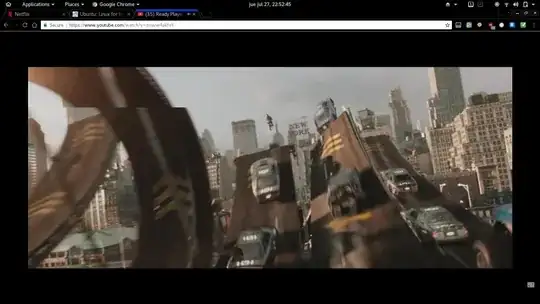

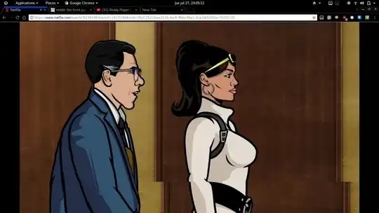

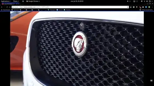

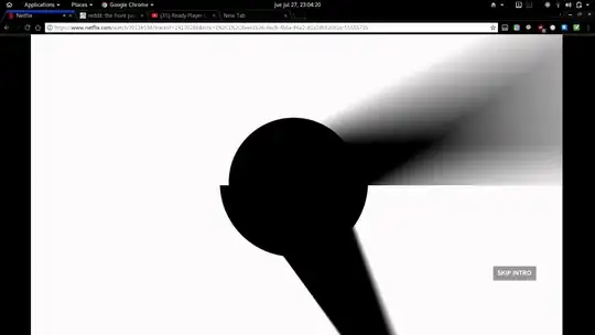

For around 1 week so far I've noticed screen tears and other graphical glitches.
I have only noticed them while browsing (in Chrome and Firefox), either while watching streams in flash or html5 format (Netflix, YouTube, twitch, even gifs) or scrolling through a big screen of text or images.
Here are some examples of the glitches I see:
screen drawn with bad horizonal alignment in one place
tear
tear
tear
This is really annoying, since it is constant and is very distracting.
The issue started on Ubuntu 16.04, and I did a fresh reinstall of Ubuntu 17.04 thinking this would solve it, but it didn't.
Currently I am running Ubuntu 17.04 64-bit version on an old Dell Studio 17. This is the gpu info:
lspci | grep VGA
02:00.0 VGA compatible controller: Advanced Micro Devices, Inc. [AMD/ATI] RV730/M96 [Mobility Radeon HD 4650/5165]
I have tried 4 different kernel versions and the issue persists:
  1. 4.6.3
  2. 4.10.0
  3. 4.11.12
  4. 4.12.3
I don't know what to do to fix this, can you guys help me figure this out?

Install Compizconfig Settings Manager
sudo apt install compizconfig-settings-manager
In there, go to:
General -> Composite -> Unredirect Match
and add Google-chrome to the list. Be careful with CCSM - it's very powerful.
