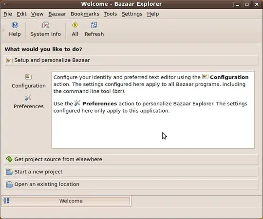

There is a graphic front-end for Bazaar. It is called Bazaar Explorer. To read more about it see:
