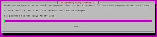

During the installation of the packages, you will see your screen change to something like this:
Enter a new root password for MySQL. This is the MySQL administrator password that you will use for making adjustments to databases and user permissions.
You'll be prompted again:
Enter your new root password again, and press Enter
