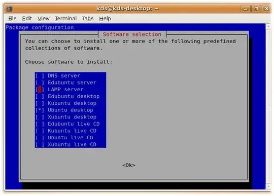

You can create pretty elaborate shell scripts. Have a look at How can I create a select menu in a shell script? for a "menu" style method using "dialog". "tasksel" is a script that is pretty fancy for command line and looks like this:
You could create something like that and make each of these a task you select and then have execute. Or string your commands together if they depend on eachother (I imagine you'd need to start all the python manage.py all the time and not as separate commands).
