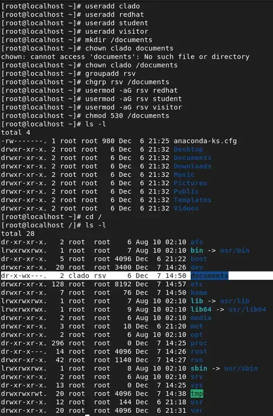

Create a directory called /documents and the user clado should be given permission to view the contents of /documents.The user student, visitor, redhat must be given permission to create files within /documents
Steps:
  • First create 4 users.
  • Then create directory /documents.
  • Then set clado as its owner.
  • Created a group called rsv (redhat, student and visitor) and changed the user's group to rsv.
  • Then change file permissions to 530. ie, r-x permission for owner and -wx permission to group.
