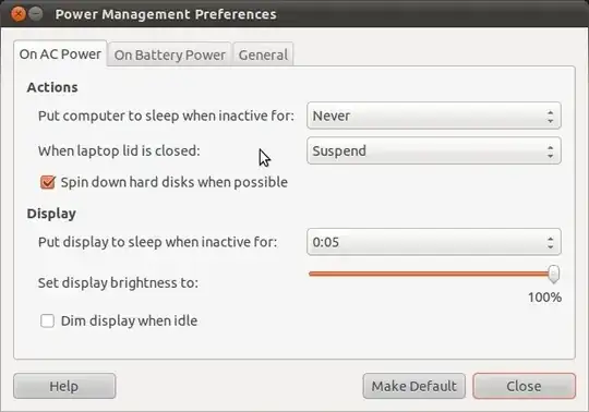

On Ubuntu 11.04 it was possible, through this config screen: power settings

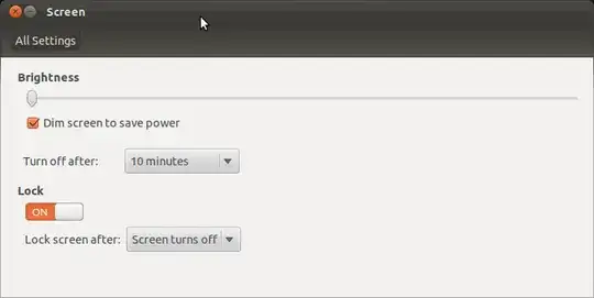

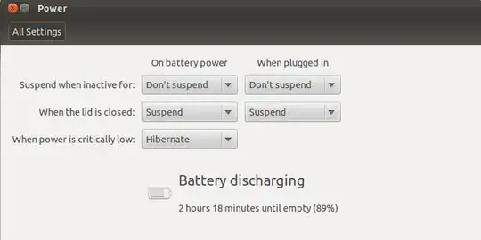

However on Ubuntu 11.10 my power settings looks like this: power settings
Is it possible to change automatically screen brightness on ubuntu 11.10 when power gets connected or disconnected as it was in Ubuntu 11.04?

Since Gnome 3 there is no way to specify a different backlight level for battery and AC - there is only one level with idle dimming enabled after a set period on battery. I can't see any good reason for making this over-simplification, as every other OS and major desktop environment supports it. I came up with my own script to perform the function of setting the brightness when a/c is connected/disconnected. Modify the script with you home directory and desired brightness levels, and save as /etc/pm/power.d/00-brightness (also add executable permissions using chmod 755 /etc/pm/power.d/00-brightness)

This setting seems to have moved to the "screen" panel.
