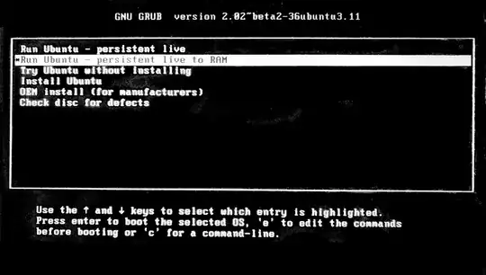

I followed this article: Create a persistent Ubuntu USB which boots to RAM so I can have Ubuntu running from a USB and it will persist any changes I make.
The problem is it doesn't persist - I created a text file, saved it, and shut down. Than I boot my laptop, pick the USB from the menu, I see the Ubuntu OS but the file is gone. I tried the first option (using the hard drive) and the second (using the RAM).
