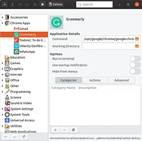

Here is the easiest and fastest way.
Install Menu Editor:
sudo apt install menulibre
Open Menu Editor, Select App, Click on icon to select a new icon:

You can change icons from Chrome's Apps by:
  1. Right click start menu and click config/setup
  2. Go to Menu tab and click Open Menu Editor
  3. Go to Chrome Apps, select the App you want to change icon and click property
  4. Click in the icon image and there you will be prompted to select icon
My SO is in Portuguese, so I don't know the exact button names.
