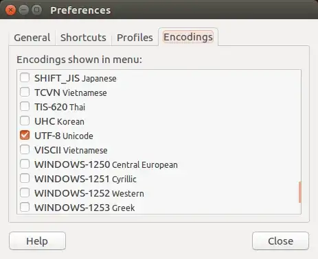

Newer versions of Gnome terminal use UTF-8 by default, but if you need to enable other encodings you can do so from Edit -> Preferences -> Encodings.enter image description here
Or in dconf at the path /org/gnome/terminal/legacy/encodings. This allows you to change it programatically using gesttings:
gsettings set org.gnome.Terminal.Legacy.Settings encodings "['UTF-8']"
