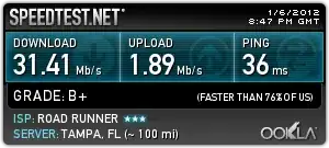

I have 20Mb/s Down, and 2Mb/s Up, during the day I actually get closer to 30Mb/s Down and 1.7Mb/s Up, then in the evening I get about 18Mb/s Down, and 1.5Mb/s Up.
Speed Test

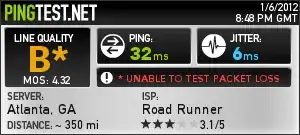

Ping Test
The only reason my ping test is a B is because It cant test packet loss because I don't have java, I ran the ping test on a Windows computer on the same network, and it was an A and packet loss was at 0%.
