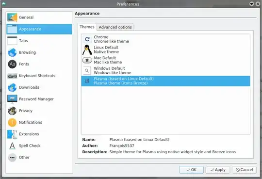

In order to install a new theme in Qupzilla (including for an appimage) you have to put it in ~/.config/qupzilla/themes/.
It seems the theme you mentioned is not available at the same link anymore and there are not many others available. I have found this one and tested for the purpose of this answer, although it is almost identical to the default Linux theme.
