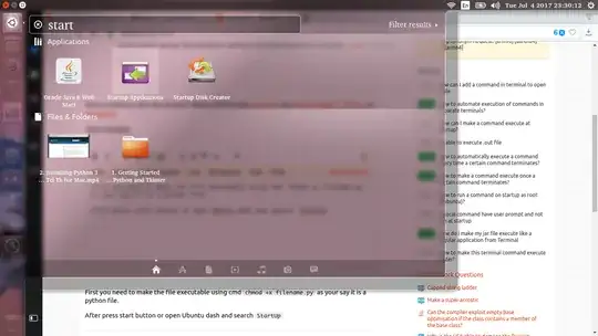

After press start button or open Ubuntu dash and search StartUp
Startup Luncher

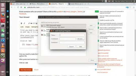

Click on Add
Menu list in Startup
You will able to see as above now enter name of command and provide path of file, if you want can add some comment. now click on add, your program will run on startup
