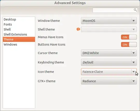

You are using a tool for GTK+2 in a GTK+3 setting. To change the theme at Ubuntu 11.04 and later, you will need gnome-tweak-tool instead.
