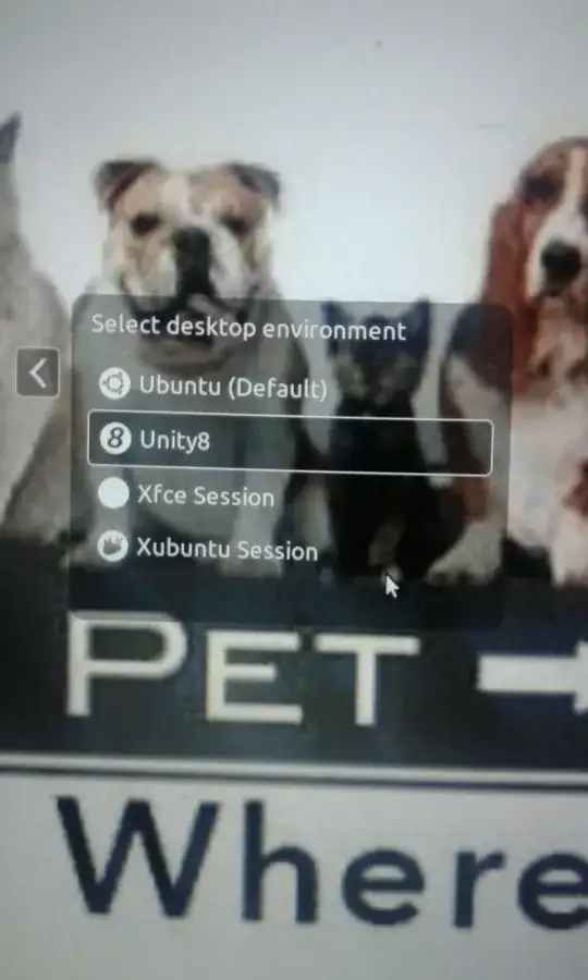

And i installed xubuntu and logged and settings are same. Missing icons. SO it is not about unity?
I have those enviroments: enter image description here
