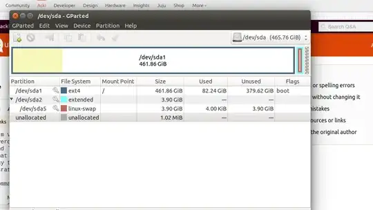

gparted

Memory is divided into "pages". when memory fills the system will write some idle pages to disk so that it can use active memory for other programs, this is called paging.
Swap Space is the disk area the system uses for paging. on some systems it is a file. Ubuntu and other linux/unix system use a drive partition for swap space. While a swapfile can grow as needed, it is subject to fragmentation. Since memory pages are all the same size, a swap partition does not have fragmentation issues but is limited to the size of the partition made for it.
Swap space is also used for hibernation. Thus it is recommended that swap space be at least twice the size of your installed memory.
If you can post a screen shot of your partitioning information, I can give more dtailed instructions on adding space if you need to
