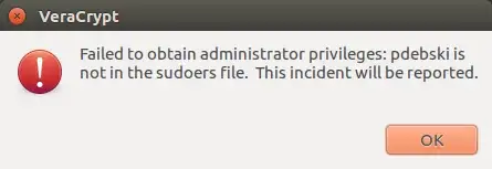

I have a number of external media with VeraCrypt encrypted file containers and I would like the users to mount and use them without giving root privileges to the users.
However at the moment VeraCrypt's always asking for user/admin password apparently sudo-ing mount operation:
VeraCrypt fails to mount pdebski not in sodoers
How can a user, who's not in the sudoers file mount an .hc file?
