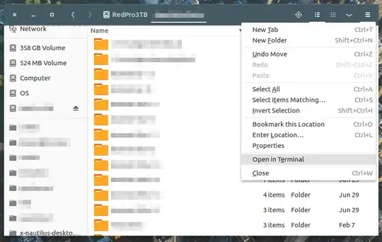

On Ubuntu 16.04, I can click the menu to the top right of nautilus and select "Open in Terminal", which is incredibly useful. Better still, if I'm browsing some sftp / sshfs share, I can even select "Open in remote Terminal". I've really come to rely on those simple but incredibly useful options.

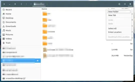

In Ubuntu 16.10, those options are completely missing. I know there is the context menu, which let's me "Open in Terminal" as well, but that's pretty useless if the folder is full of files and a file is selected, I can't un-select it. Also, the "Open in remote Terminal" option does not exist in 16.10 / Nautilus 3.20.3.

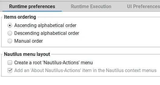

First, change the global preferences to display actions at the root of Nautilus menu (instead of nested) : go to Edit/Preferences menu and uncheck the "Create a root 'Nautilus-Actions' menu like below :

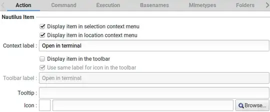

Click on Ok. Now, we add our action : go to menu File/New Action and check "Display item in location context menu", change the "Context label" to "Open in terminal". See below :

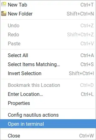

After launching a new nautilus window, you should have someting like that in the top right menu :
