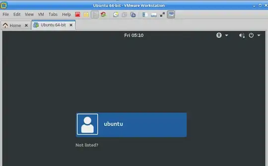

I just installed a fresh Ubuntu Server 16.04 in VMWorkstation, installed openssh-server. connected via terminal (ssh) and installed gdm and rebooted. I now see a graphical login screen.
