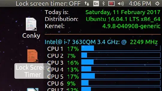

There is a bash app I wrote that might be over kill: https://askubuntu.com/a/837115/307523
Lock screen timer giphy
It displays a count down timer on the top bar though not the side bar like you requested.
The default time coincidentally to your needs is 30 minutes but you can change that when calling the app.
The app repetitively calls itself so after say 30 minutes you can add another ten minutes.
As the count down approaches zero message bubbles appear and soft chime is heard at 15, 10, 5, 3, 2 and 1 minute remaining.
When the count down timer hits zero the normal lock screen and password prompt appears.
Because the app is written in bash it can quickly be tailored to your needs.

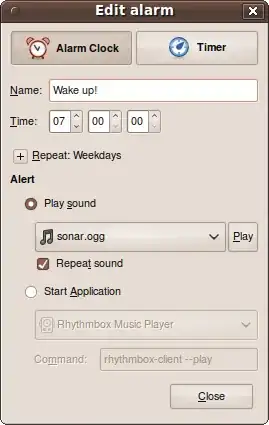

There is a timer section in the alarm clock applet. Download it from here. enter image description here
Alternatively, you can install it with the following command
sudo apt-get install alarm-clock-applet
