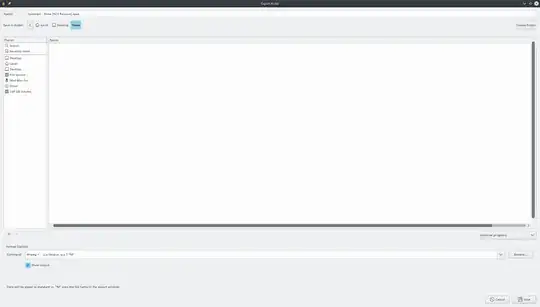

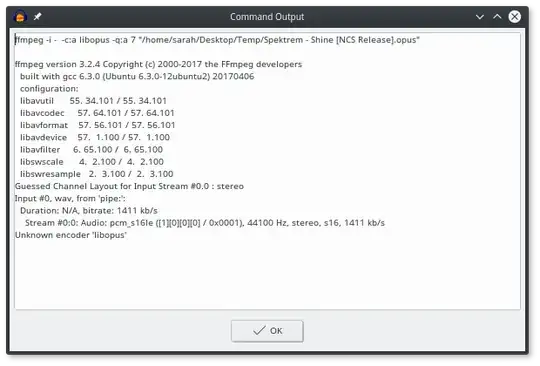

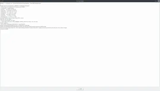

Edit 0: (After trying the external program and the file not appearing): Export Audio Program Output
Edit 1: After Recompiling A file with the file name now appears in the folder, but it appears to be unplayable. After Recompiling

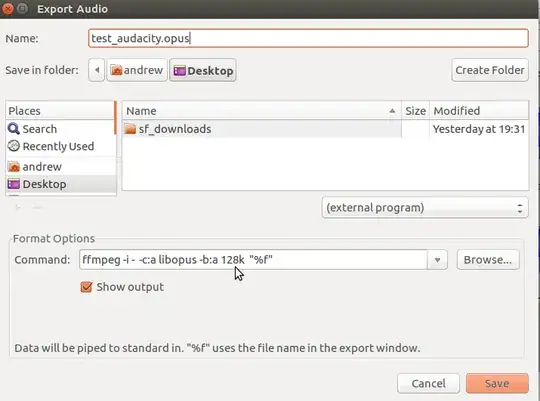

2. Exporting Opus Files with Audacity
Audacity can export as Opus but does not have the capability to directly export as Opus or to use the conventional 'Custom FFmpeg Export' setting.
Instead go to:
File --> Export --> External Program
and change the Command options to something like the following:
And to make copying and pasting a little easier here is the command line:
ffmpeg -i - -c:a libopus -b:a 128k "%f"
And this should give you the results you are after...

EDIT
ffmpeg does not support quality settings for opus. Here is part of the output using today's 3.4 git snapshot of ffmpeg when trying something like
ffmpeg -i - -c:a libopus -q:a 7  "%f"
as command:
[libopus @ 0x3f065c0] No bit rate set. Defaulting to 96000 bps.
[libopus @ 0x3f065c0] Quality-based encoding not supported, please specify a bitrate and VBR setting.
