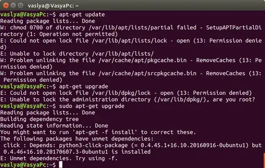

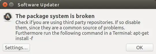

Before I have read more sources like this but didn't find an answer for my error, which is related with system updating package. We can see on top right here:
I have not so big experience in it. The error of updating like here:
proposes me to execute:
 apt-get -f install
also, I had been tried
sudo apt-get install -f
sudo apt-get -f install
apt-get install -f
but I have other error:
Please, maybe anybody has experience in that, thanks.

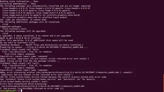

when I execute successfully:
sudo pip3 uninstall click
I still have the same error: enter image description here
When I execute the command:
journalctl -xe
I have: enter image description here It seems like I need to install click.
