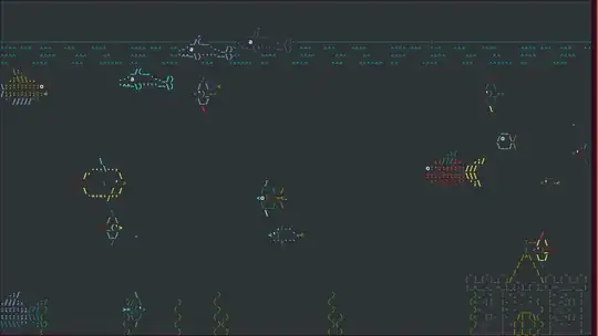

And then the application is yours to run:
Enjoy :)
